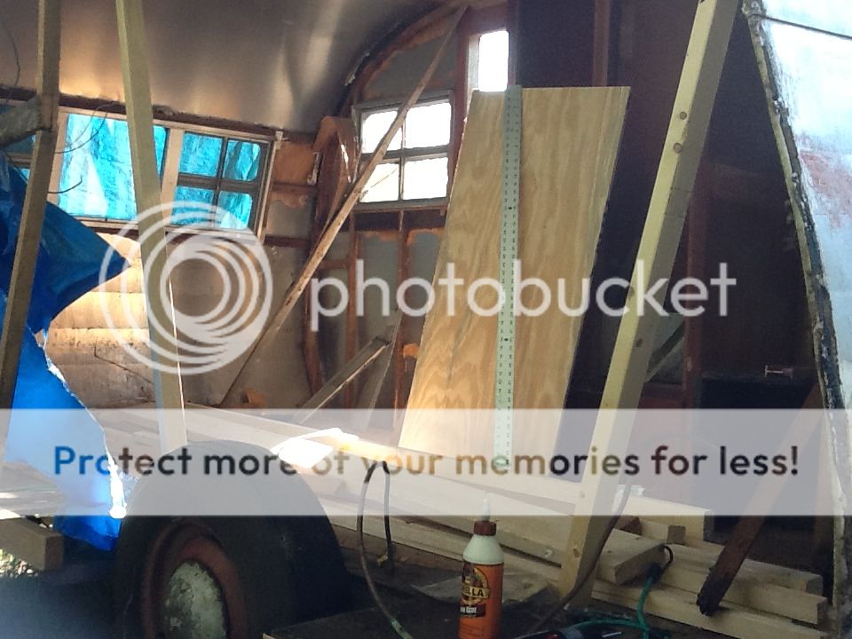

Post by egar on May 25, 2012 16:41:24 GMT -5
Getting into the thick of things.

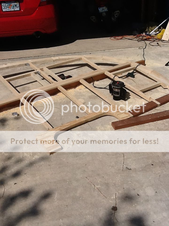

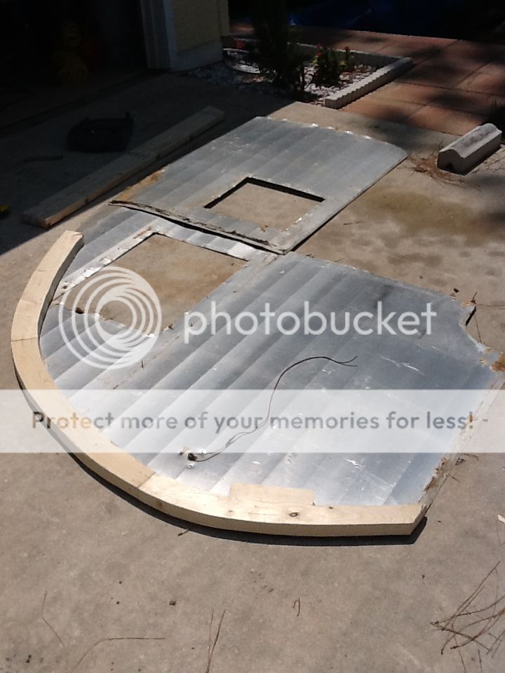

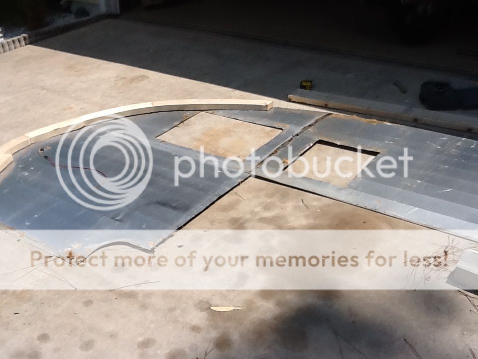

Post by egar on Jun 10, 2012 16:15:54 GMT -5
Haven't posted in a while but I've been working all weekend in the blazing sun building the port side frame. Curves make everything slow and tedious but I hope my work improves upon the original. I'm using glue and dowels whenever possible and galvie screws. No nails. I have to patch the floor and replace an outer joist before I can tie this huge section into a action I could salvage. Used a router to add the recess for the ceiling beams. Will add more detailed photos if it will help anyone out there.

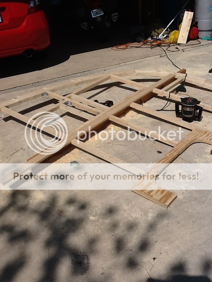

Post by egar on Jun 10, 2012 16:21:17 GMT -5
Another view

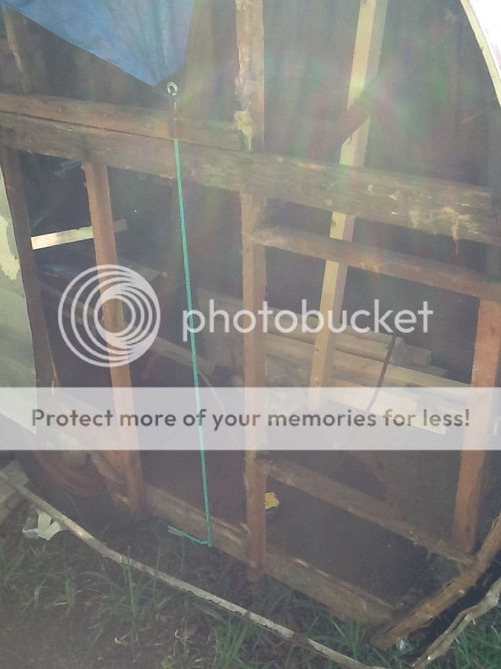

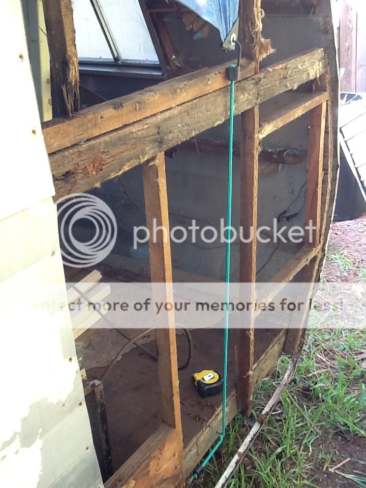

Post by egar on Jun 12, 2012 18:52:52 GMT -5
The whole side almost collapsed when I installed the new frame section. I'm hoping everything is right. I have no reference points anymore. Had to cut up part of the floor to replace an outside floor joist in front of the wheel well.
