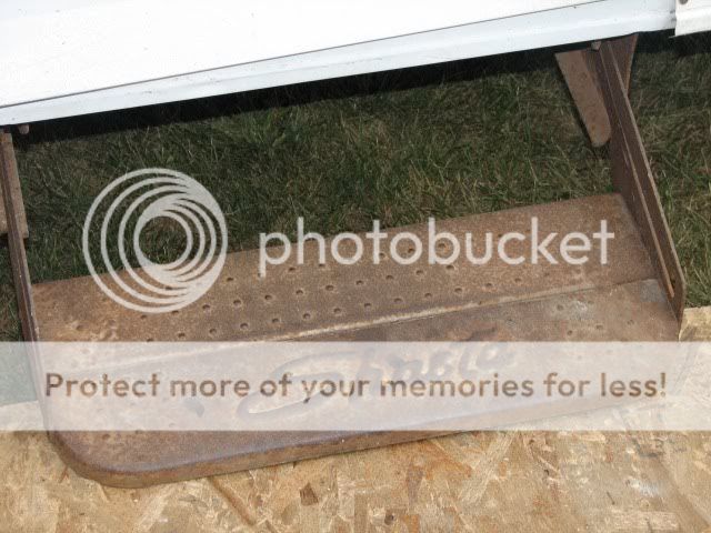

Step on my '64 Airflyte. Tread measures 20" X 8" with an overall length of 21" with the mounting rails. It appears it's the same measurements as the one VTS has, only with the logo. The end bracket is about shaped like C-channel, but I am sure is stamped steel. It is about 6" wide, and hangs about 5" below the mount. The upper "lip" of the channel is about 1-1/2 inches, and the lower "lip" is about 1" wide. The rail that goes between the two ends that the step runs in and out on, appears to be 1/4" steel rod, and is located 2" down from the frame mount and 2" back from the outward edge of the mount rail. The brackets attached to the ends of the step is a little hard to measure because of its funny shape, but is about 11" tip-to-tip. It is mounted so the end is 6" from the rear edge of the step, about 2 inches back but hard to get an accurate measure on the curved edge of the step corner. The slot is around 5/8" wide, and the bend is about 7" from the end with the funny cut. That cut is made to hold the step in when traveling.

thanks for the pics, I have a step but I will have to build all brackets to get it mounted, this should help.

Somehow I managed to lose all the original photos from this post, ... so I took some new ones today and posted a few here. There are a few more on the page below, please help yerself if you need: s1178.photobucket.com/user/crw2620/library/Airflyte/Shasta%20step?sort=3&page=1If I can be of more help please let me know. I know the photos are not real great, so if anything needs to be cleared up, I'll try to help.

been doing some checking, I need the bracket to mount the step under the camper, the good news is I can get it from vintage trailer supply, the bad news is it comes with the step, and is $47.99, then I have to figure out how to cut the new step off the rod and get my Shasta step on it, looks like I would have to cut out a section of the rod groove, put the step on then weld the section back on. www.vintagetrailersupply.com/Folding_Step_5_25_Drop_p/vts-693.htm
Post by Deleted on May 21, 2013 21:20:50 GMT -5
You may be able to cut the rod out and replace it, either grind off one end and slide it back in, or replace it with a new piece and tack it in. Then it would nt require cutting up any of the bracket.
