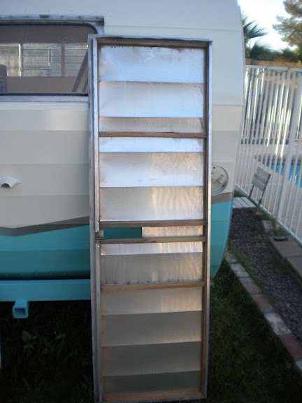

i've been trying to convince myself to leave the door alone and just put a kickplate at the bottom, but it is so rotted down there i just couldn't help tearing into it. here is a before pic. i'll post some more pics tomorrow of the initial demo. i am excited to put some insulation in there and to have a fresh piece of shellac'd birch on it when done. shouldn't be too much trouble i hope. i will also post some pics and questions about my bargman L-66. there was a loose piece in there when i took it off and i need to identify what it is. wish me luck! paul

okay, i got out there early this morning and dismantled the rest of the birch from the door. i'm not sure if i will replace all of the support wood or not, but some of it will be new. notice in the pics where a screw missed the wood almost all together! out with the old... a fresh canvas... this will be good to have replaced with something solid... oops!

I just finished building a new door this weekend. The only part from the original door that was reused was the upper aluminum skin. I'm trying to figure out a clean way to weatherstrip the door a little. If anybody has any suggestions, please let me know.
As to the question of making a solid core door, my opinion would be why bother? The way the door is originally made is similar to a hollow core door. Maybe not the best for security, but less likely to warp than a solid door. As to weight, I doubt the hinge would have problems holding up a heavy door.
One other note. I kind of wish I had put a window in the door. a smaller fixed glass window in the top would ahev been nice, even though certainly not original.
