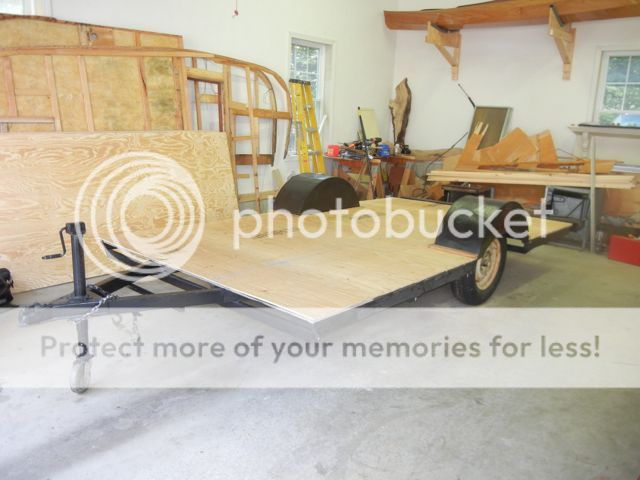

Post by Deleted on Aug 24, 2012 19:37:59 GMT -5
Hello all, It’s been a little while since I last posted my progress, so here’s where I’m at. It seems that I kept saying to myself, ‘I’m this far into the project I might as well go a little farther and fix this too’. I said that to myself a lot…the result was that I ended up stripping the camper all the way down to the frame. I guess I’m not one to let something that’s questionable go. Anyway, it’s all starting to go back together. Since the demo was completed I’ve sanded and painted the frame and wheel wells, replace some of the wood framing with new pt wood, painted and installed Homasote 440 Composite Sound Board, new plywood subfloor and lags bolts. Over the next couple of weeks the new Armstrong vct checker board floor will go in an then the walls will be reframed, paneled and installed. I was fortunate enough to find a local specialty plywood dealer who had 1/8 birch in 4x8 sheets. A bit pricy at $39 a sheet, but at least I found some. From here my plan in to modernize all the systems but keep the interior and exterior looking as original as possible. My wife is looking for her garage space back, so I guess I better get a move on. Regards Steve

Post by Hamlet on Aug 25, 2012 9:43:27 GMT -5
You won't regret taking it down to the floorboards... in the long run. Looking good!

Post by Gone Kayaking on Aug 26, 2012 13:40:51 GMT -5
Agree, if I was doing over and had a nice workspace like you do, that's what I'd be doing. Also I think paying for quality birch ply is a smart investment, the cheaper stuff I got at $20 per sheet has a razor thin veneer....which I learned the hard way.

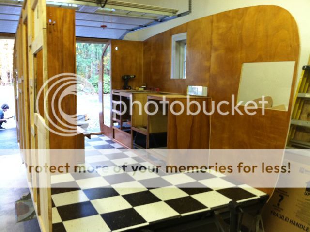

Post by Deleted on Oct 5, 2012 16:04:38 GMT -5
It's been a while and the rebuilt isn't progressing as quickly as I would like. Here are a couple pics in her current state. Next up, systems, Propane, trailer lights, electrical, fresh, black and grey water. That should keep me busy for a while.

Post by Deleted on Oct 17, 2012 17:04:25 GMT -5
Hello all, The last couple of weeks have bee productive. I was able to get the ceiling panels shellacked and installed. The font end and the ceiling framing are also done. There is still plenty to do before I address the skin issue. I’m still in the process of collecting parts for the electrical and plumbing systems. I also need to build the front dinette. It’s starting to get a bit cool now so I really feel fortunate to have some garage space, which will allow me to keep plugging away. Hopefully by Christmas the interior, windows and misc metal will be done. The trailer will be 50 in April…that’s the completion date I’m shooting for.
