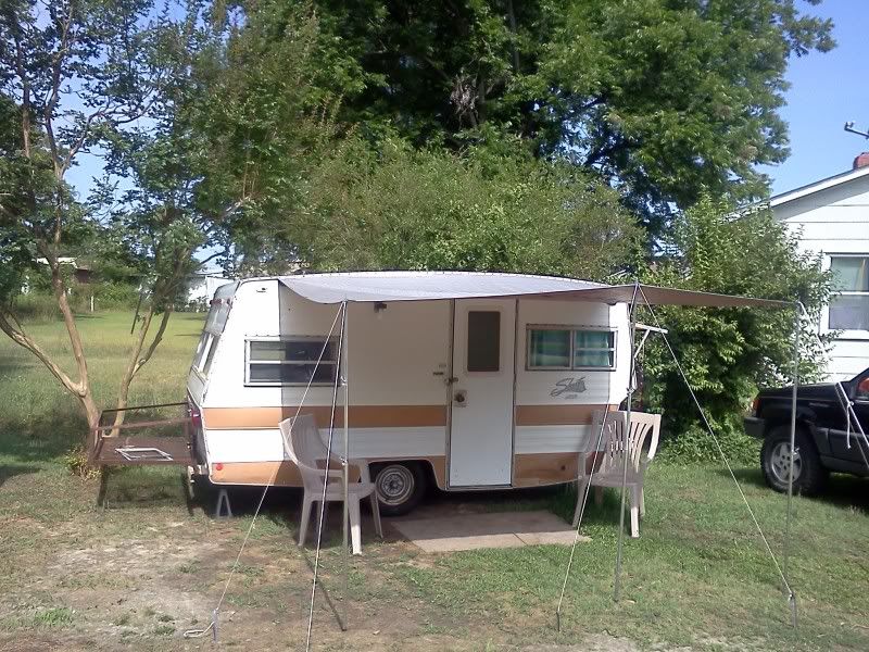

well i bought me three adjustable tent poles and a brown and silver tarp from walmart for$38. cut the cord off my broken impact gun and put the tarp and cord in the slot and instant shade now

Well I loved your idea so much i had to make my own today. I used an 8.6'x11.6' tarp and I had a rope sewn into it by my wife. the tent poles I used were 2 pieces of EMT conduit one 1/2" one 1" I cut them in half lenght wise and welded a 4" bolt into the end of the 1/2" piece and drilled some holes and put a 1/4" bolt thru them to raise and lower the poles I will have to get them painted soon but for now they will work !

And it worked just like he said! I bought the 10'x10' tarp at Northern for $13.00. The perfect wire / cord for mine was some Network Cable. Semi stiff and Time Warner left alot in the wooded part of my place when they reworked some stuff. Threaded in like nothing to it. I did file the hard edge at the start of the track. It was kinda snaggin and grabbin abit. The poles were from my gear locker as they went to the old blue 12x12 dining canopies from the 80's. Grant you I'd love one of the vintage custom job and it will come, but this will get us thru the summer... Cool Beans Attachments:

Hey Pathfinder, is that coax cable (tv cable)? Seeing as how I work for TWC that should be easy enough. I may even have some in a box somewhere from my days working in the field). Yes it is Kayaxi, First I tried the traditional orange "drop-chord", no go. Played around with some other stuff in the garage and BINGO! The coax cable fit perfect with the heavy silver trap. Watch for snags though when you start threading it into the track and have someone assit you. First, I ran the cable in alone to clean the track and get a fill for the length. (10') I took a machine file and rounded the open corners abit. Just a little, nothing to drastic. Then the wife help support tarp, fed it forward as I slid it in. I was surprized how simple it was. I think that the rope system would be sloppy and frustrating. I liked the rigid feel of the coax. Good luck with yours.
