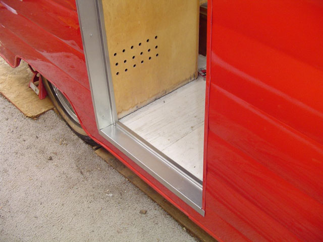

I agree, your videos are great. So helpful to so many. I"m curious about your 57 Shasta. What part(s) do you consider to be "not built right"? I have two here, maybe should be eyeing them a little more closely... I'll start with the worst thing I found so far. This one I never expected in my wildest dreams. I usually don't take up the thresh hold until I am ready to paint the floor unless I am replacing the floor in that area. This is so I dont tear up the metal going in and out. So I never caught this until it was too late. This had to happen at the factory. When I took up the thresh hold I found that the main floor to ceiling cabinet had been placed 3/4 of an inch outside of the trailer and fastened there. Then the guys who put up the curb side wall just put it up right over the mistake. I guess the guys puting on the skin noticed the mistake and instead of stopping production for a bit and moving the cabinet, they just put a 20 inch wedge in the bottom so that the skin would lay flat against the otherwise empty space. It is for this reason that I wish I would have done a complete off frame rebuild on this trailer but that's not the only thing I found. Here are photos showing this problem... In the last photo you can see why I didn't notice it. I did a complete rebuild on the door and am just now getting ready to hang it. I hope this does not give me new headaches but I can't see how the door is going to close properly and I don't know how they made the old door close flush. Besides the normal screw ups like the solid dinette windows that are next to impossible to seal, and the cellotex underlayment that squishes in no time and makes the trailer float up and down on the frame, there are the wheels that I can't get off without deflating and squishing the tires. But there's more..... You can see in my videos that when I lifted the marmoleum from the bed area, they used a ton of small pieces of plywood for the floor and ten thousand nails. They must have been short of plywood at the time because no piece back there was larger than 2 feet. Then there are the rough openings for the windows... It's nice to have maybe an eighth to a quarter inch slop to make the windows go in with ease, but these rough openings were so big that there was barely any wood to screw to because the openings were WAY TOO BIG... To top it all off, I didn't find this on this Shasta but on the last Shasta that I worked on with Bob Ross, (I put the floor in that one and that was in my videos also) the curb side wall was 1 & 1/2 inches shorter than the street side. We figure they mounted the street side too high or the curb side to low or a combination of the two. Another thing I found and this is in the videos also is that the frame had been bent before the floor was installed at the factory. They just installed the floor without straigtening out the frame first. Geeeesh... I just don't see any quality control ever having been done on these trailers. They seemed to have banged them out as fast as they could with no regard to quality. As long as it rolled down the street without falling apart it was good. If I ever do another Shasta it will be a complete off frame rebuild. The only thing that will remain original in the trailer will be the appliances and cabinets. Except for the frame it sits on, everythnig else will be new.

Post by mobiltec on Jan 25, 2013 15:45:57 GMT -5
Here's how it looks now.
